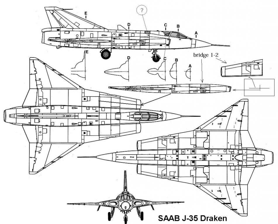

              hej alla sorry i hope you can help me I have a "small problem". I pulled out a triptych of drawings to CAD for the Draken "F" in the triptych, but there are only the major ordered. I would have to generate new order for the air vents that are not present in triptychs, but which are equally important to generate a three-dimensional than that of the lost air wing of the plant.
              so you tell me if there is a system to generate it or whether there are any patterns that they have already '? .. sorry och tack angång till.

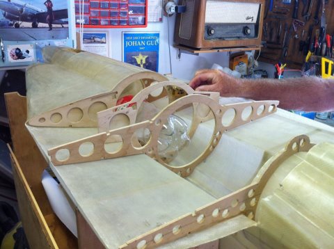

Namn: 418486_10151002998768803_440493392_n.jpg
Visningar: 2
Storlek: 39,8 KB
ID: 490325Ok en startbild.
                MVH Uno.

                    TACK SOM MJCKET UNO! den ar absolut detta är mycket bättre, att göra nya beställt.
                    a question! ... but on the Draken there is an area which tends to rise to fall back gently? ..... see photos! ....
                    However, I think I have found a good way to achieve any of the form frame. in practice is to build bridges with the two forms of the two perspectives (top, side "airfoil" ) and use the two ordered C-C and D-D as a guideline.Klicka på bilden för större version
Namn: saabj35_3v.jpg
Storlek: 107,3 KB
