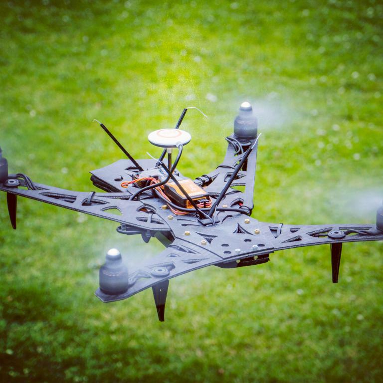

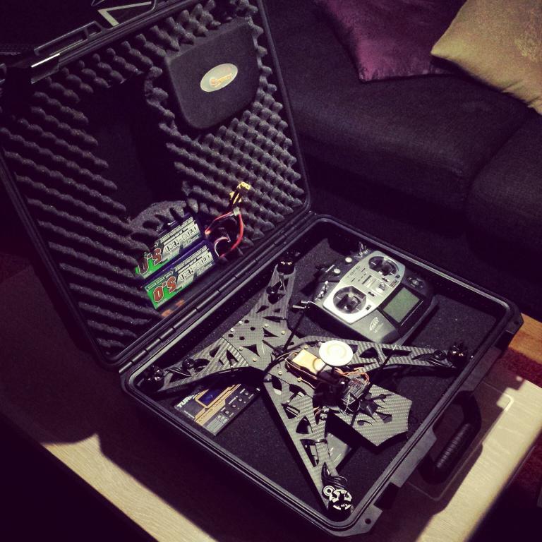

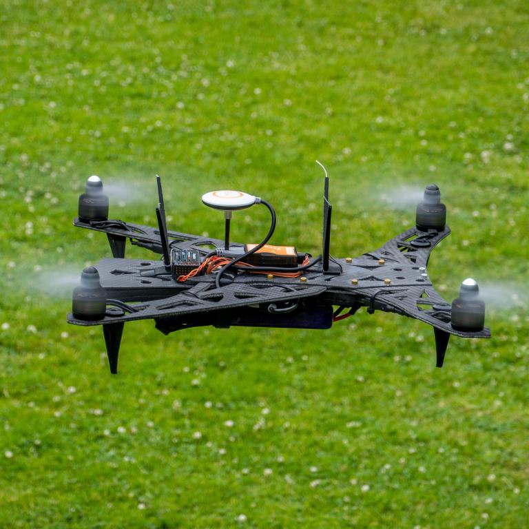

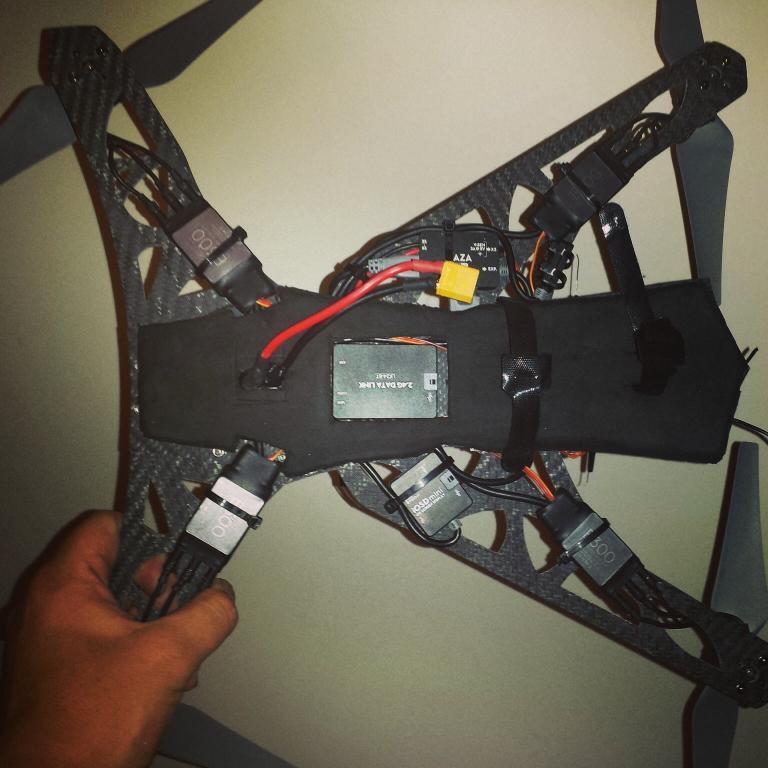

            I love the TBS discovery machine, however I also have a passion for making machines that are lighter.
            I have been given a task to design and build a longer range FPV quad with 20+ mins battery life.
            Frame is a complete custom made composite made from 3k CF and a special lightweight core. 3.5mm thick, completely rigid and VERY strong.
            Im using the well tested DJI E300 propulsion kit. This is the first time ive used self tightening props and I must say they amaze me! literally just drop them on.
            kit used in on my machine:
            440mm CF frame with Aluminium screws
            Naza V2 with GPS
            Naza wireless link for ipad groundstation
            Mini iOSD
            DJI E300 Propulsion System
            600mhz VTX (still waiting on)
            Skyzone FPV goggles tith cloverleaf and spiral antennae.
            3s 5000 battery, will also test with 7000
            Front mounted 2 axis GoPro gimbal (still working on)
            3D printed legs.
