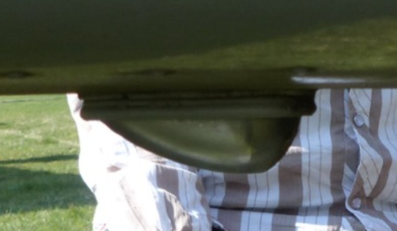

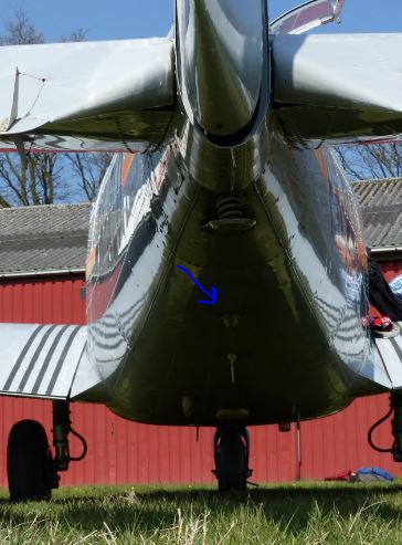

      Can anyone tell me anything about the white light on the underside of the tail? In all footage that I find online it is switched off, so I can't see the way it shines. Does it shine mostly towards the tail, or in all directions?

        Här står hur det skall vara. Bakåt, men inte fullt 180 grader tror jag.

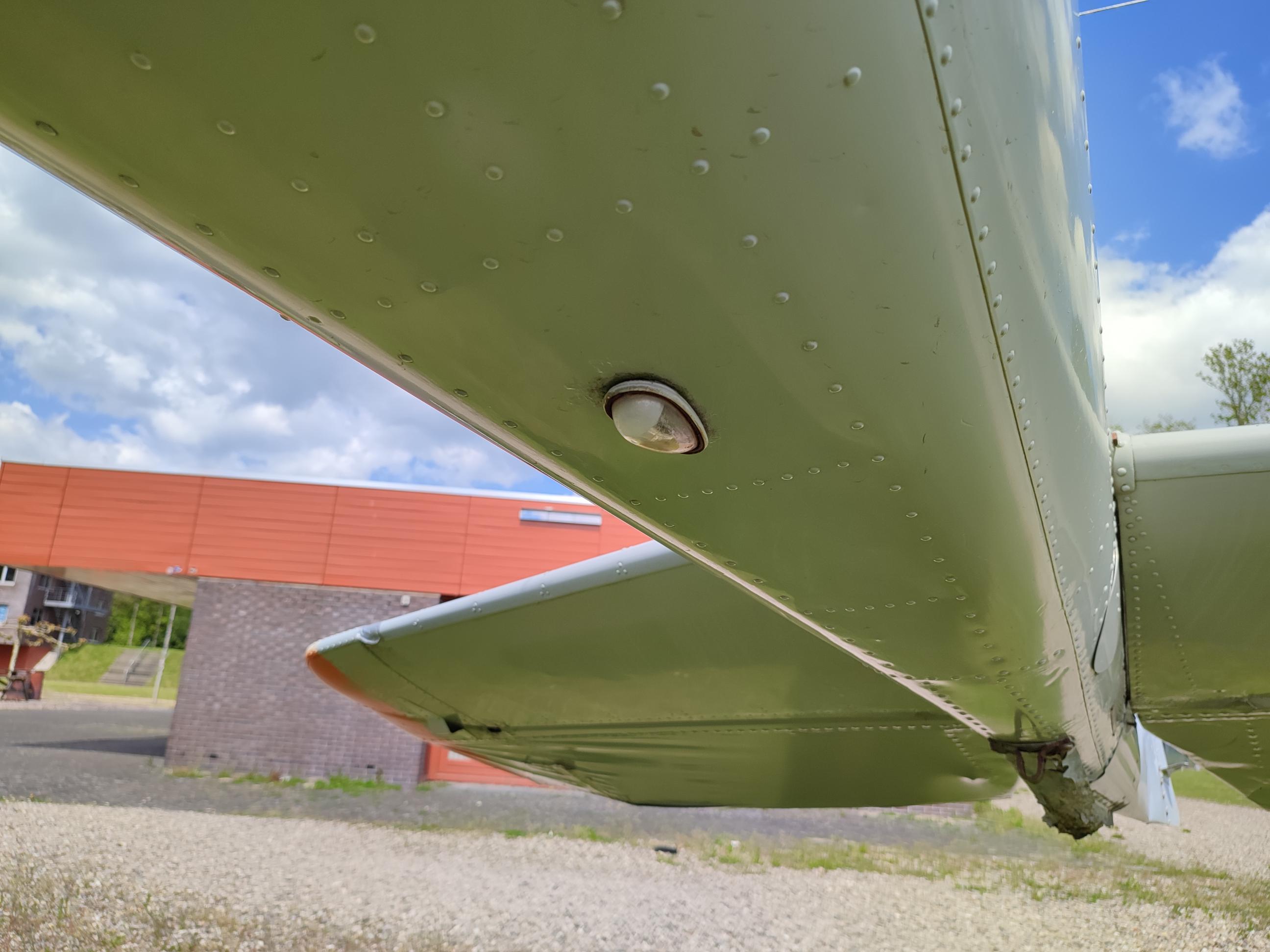

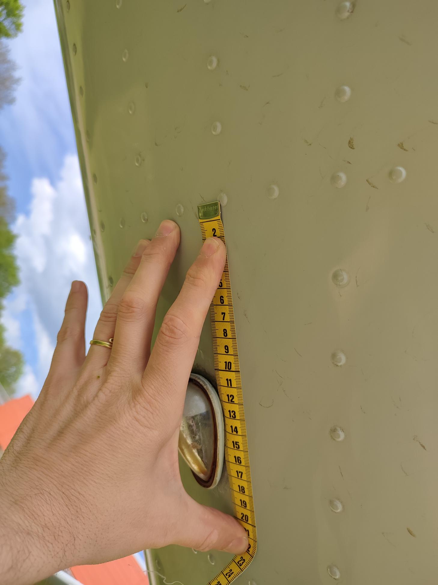

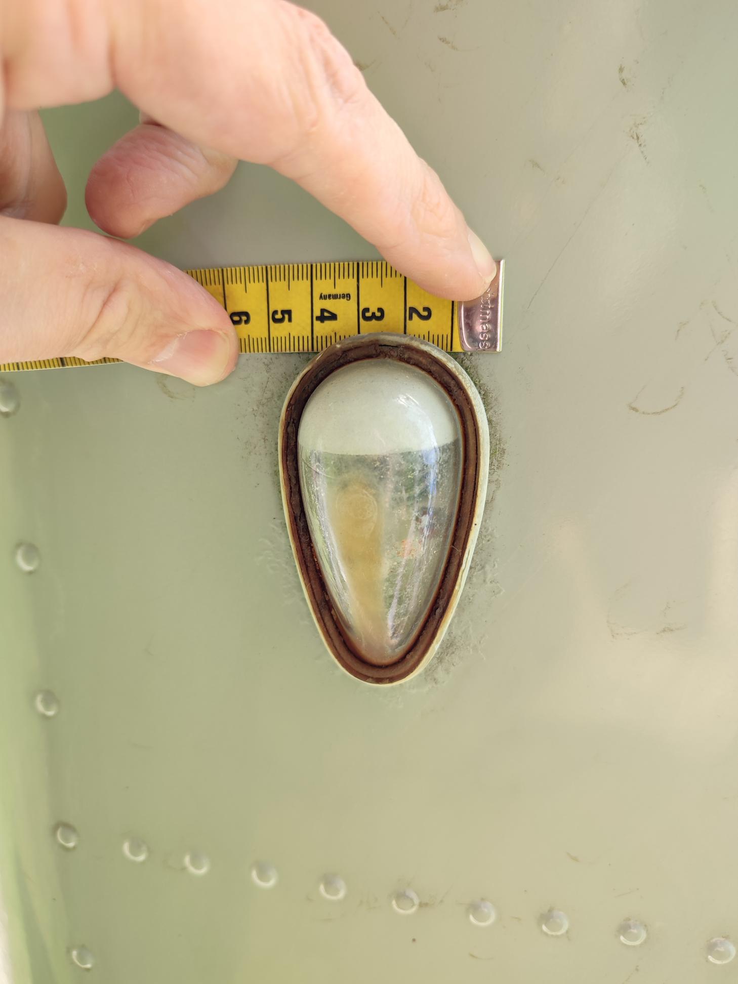

            Thanks. I visited the old PH-RLS at Groningen Airport Eelde and got the missing detail that I needed. The front of the cover is blanked/frosted.
Namn: IMG_20230520_133727.jpg
Storlek: 305,0 KB
Namn: IMG_20230520_133932.jpg
Storlek: 139,7 KB
Namn: IMG_20230520_133836.jpg
Storlek: 130,5 KB
