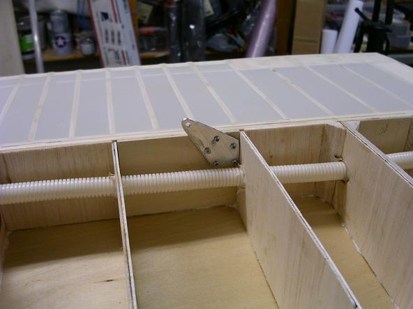

    Med hjälp av mitt bandsåg försett med en metallklinga, fil, borr och lite tid så lyckades jag forma till alla fyra vingstöttsfästena som skall sitta i vingen.
    Så här blev plankningen på höger vinghalva. Jag fick spackla lite i mitten på grund av att det blev en liten glipa mellan skivorna och en liten höjdskillnad.

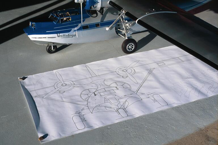

            Hello, I am Davíð Sturluson and I have been noticing you are currently making PBY Catalina after the design my father created.
            It seems to be going well for you, he himself was 5 years doing it... but he had to make the plans in those years also. I've seen the model fly many times myself, the plane is so heavy that the landing is extremely hard. So when you take it for first test drive remember to land carefully or the wheeling system will most likely bend or break.
            I write this in English cause my Swedish is not good at all, I however read all the thread with Google translate. My father himself has been watching this thread some, just to see the picture.
            We will keep on reading this thread, I hope you'll finish making the model next year.
            -Best regards Davíð Sturluson & Sturla Snorrason.

                  If you guys want more picture of the first and original PBY Catalina 1/8 Scale by Sturla Snorrason, then I can get you many picture.
                  Also my father was wondering how you are making to make the landing gear, most of his customers have asked him many questions about it and even asked him to make it for them, he has not done so yet.
                  -Davíð Sturluson

                      Yesterday, I studied the plans for the landing gear and tried to figure out which part goes where. And I think I managed to figure it out. :stupido2: I could use a couple of pictures showing the different parts from different angles. And if it's possible, a video showing how the landing gear operates. That would be very useful.
                      I will use stainless steel tubes to get a rigid setup.
                      Goran

                        My father is going to try to scan some photos he has, as it is very hard taking picture of the front landing gear.
                          • 3999
                          #102
                          Ursprungligen postat av Karmine
                          Thanks! I appreciate it very much.
